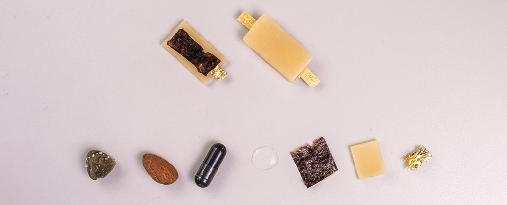

    Built from a varied list of ingredients, it's the first functional rechargeable battery that can be served as a snack. Its components include the vitamin riboflavin for the battery's anode (its 'negative' end), and the supplement quercetin as the cathode (the 'positive' end). The electrolyte (which generates the electrical charge) is made from a water-based solution, and the separator (which prevents short circuits) is made from nori, the seaweed you find at sushi restaurants.
    The prototype in action. (Ilic et al., Advanced Materials, 2023)
    Activated charcoal, often used to treat poisonings, is included to increase electrical conductivity, while the external contacts that transfer the electricity to another device are fashioned out of beeswax, connected to food-grade decorative gold.
