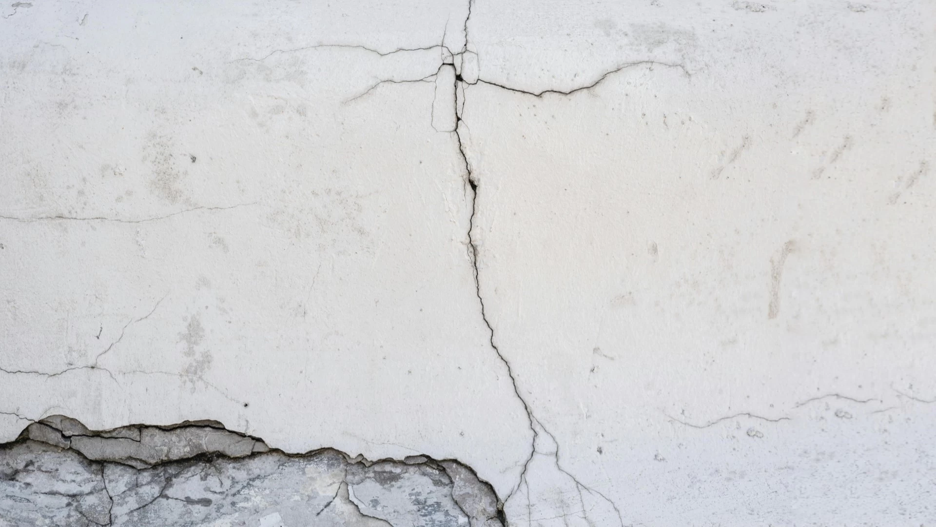

    What if the concrete in buildings and bridges could heal itself like a wound healing on skin? That’s the idea behind new research from Dr. Congrui Grace Jin, whose recent study explores a microbe-powered, self-healing concrete system. Concrete is everywhere in our daily lives—from buildings to roads—but it tends to crack with time and stress. These cracks, even the tiny ones, can let water and air inside, eventually causing rust and weakening the steel hidden within. That’s risky and expensive to fix, especially on bridges and highways.
