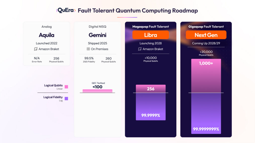

    Image of four boxes, two largely white representing what has been built, and two in purple, which remain hypothetical.
    QuEra’s existing hardware (left) and the new machines (right) promised for the next few years. That new hardware
    will require very rapid progress. “Quop” stands for quantum operations.
    The bigger challenge QuEra faces will be that these future machines require getting the error rates of the hardware qubits down dramatically. As a rough approximation, the error rates of logical qubits depend on a combination of how many hardware qubits are used to create the logical ones, and the error rate of the hardware qubits. If you get the hardware error rate down, you can get similar error correction performance out of a logical qubit built with fewer hardware ones. (Some of the more efficient error correction schemes use fewer hardware qubits, but there are limits to how far this can be pushed.)
    In its 2028 machine, QuEra will be using an error correction code that requires 40 hardware qubits for each logical qubit. One year later, it intends to cut the hardware qubits per logical qubit to 20. Cutting it to that number will require the hardware error rate to go down just to keep the same level of performance, except QuEra is also promising dramatically better performance, which means the hardware error rate will drop even further.
    It’s unclear where that sort of drop is going to come from, especially given it’s only expected to take one year. When we asked QuEra about the biggest challenges remaining, the error rate wasn’t mentioned specifically. “A lot of the challenges between now and a production system on the cloud are classical challenges, not quantum challenges: control electronics, real-time quantum error correction, building compilers that allow users to easily tap into the power of the system,” Borger told Ars.
    Although the company has listed the current error rates for its hardware (which are very good, but not presently good enough for this), it is not specifying the level of performance that will be needed to achieve its planned goals. The announcement is potentially exciting, but it’s difficult to evaluate how seriously to take QuEra’s plans.
