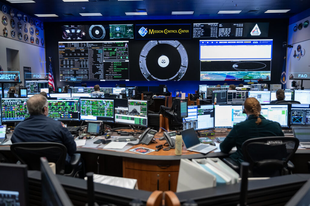

    NASA flight director Jeff Radigan (left) and capsule communicator Amy Dill (right) monitor the Artemis II
    mission from the White Flight Control Room at Johnson Space Center in Houston.
