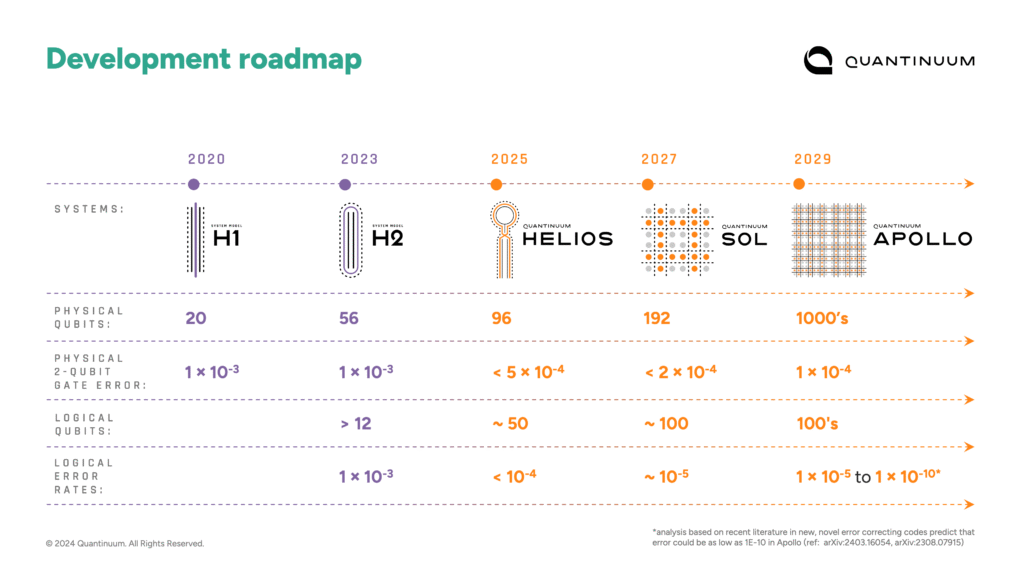

    If you look at Quantinuum’s roadmap for that future hardware, Helios would appear to be the last of its kind. It and earlier versions of the processors have loops and large straight stretches; everything in the future features a grid of squares. But both Strabley and Hayes said that Helios has several key transitional features. “Those ions are moving through that junction many, many times over the course of a circuit,” Strabley told Ars. “And so it’s really enabled us to work on the reliability of the junction, and that will translate into the large-scale systems.”
    Image of a product roadmap, with years from 2020 to 2029 noted across the top. There are five processors arrayed from left to right, each with increasingly complex geometry.
    Helios sits at the pivot between the simple geometries of earlier Quantinuum processors and the grids of future designs.
    Credit: Quantinuum
    The collection of squares seen in future processors will also allow the same sorts of operations to be done with the loop-and-legs of Helios. Some squares can serve as the equivalent of a loop in terms of storage and sorting, while some of the straight lines nearby can be used for operations.
    “What will be common to both of them is kind of the general concept that you can have a storage and sorting region and then gating regions on the side and they’re separated from one another,” Hayes said. “It’s not public yet, but that’s the direction we’re heading: a storage region where you can do really fast sorting in these 2D grids, and then gating regions that have parallelizable logical operations.”
