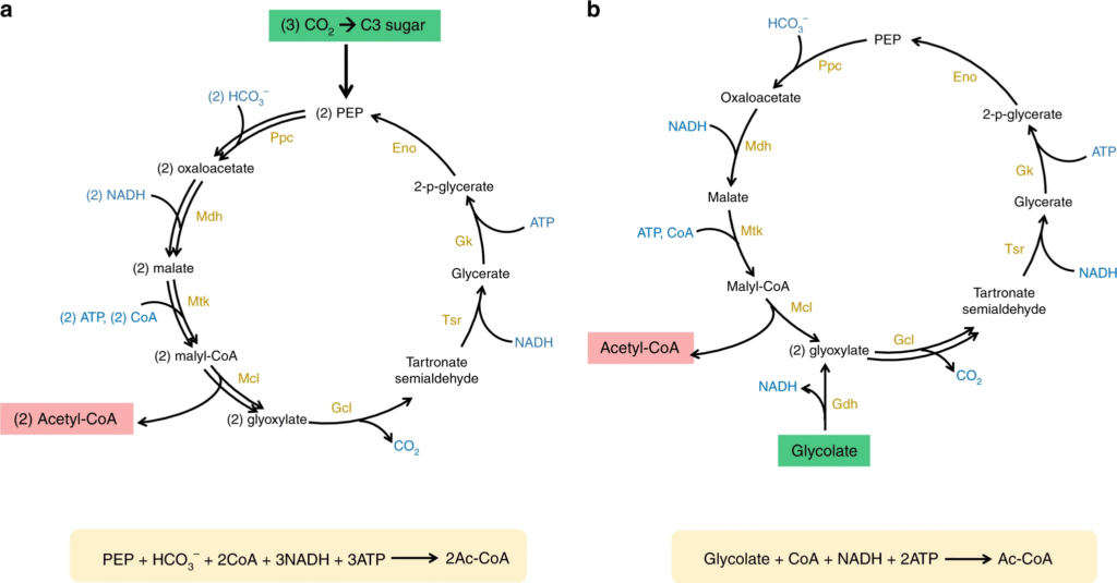

    So, the team was interested in establishing something similar to the Calvin cycle, but capable of outputting a two-carbon molecule without re-emitting the carbon dioxide molecule that had just been captured. What they came up with is the malyl-­CoA-­glycerate cycle, which they fortunately abbreviated as the McG cycle so nobody would ever have to remember its real name. The reactions of the cycle (there are eight of them) are all catalyzed by existing enzymes, though those enzymes come from a number of different species, so they don't naturally occur together.
    Image of two biochemical cycles, showing the enzymes that catalyze a set of reactions, with additional molecules entering or exiting the cycle at specific locations.
    The McG cycle has a few very useful features. It spits out a two-carbon product at one of the steps, which can be directly used in the production of lipids. It also builds that molecule by incorporating carbon atoms at two different steps in the cycle, meaning a single cycle captures more carbon than gets taken up during the Calvin cycle in photosynthesis. (One of these is technically a bicarbonate molecule, which is produced when carbon dioxide dissolves in water.) Finally, there is a point in the McG cycle where it can exchange molecules with the Calvin cycle, allowing those two systems to interact and draw off any excess materials produced by either of them.
