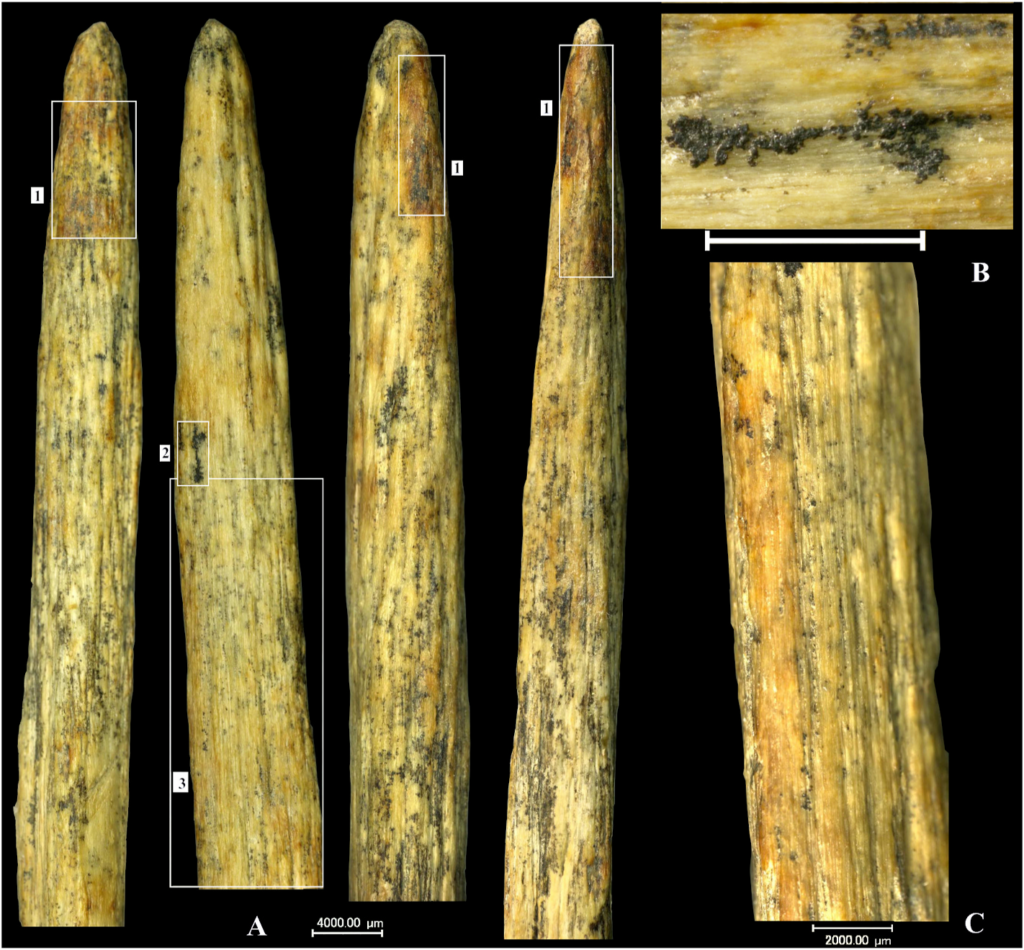

    Photo of a spear point from multiple angles with traces of dark residue on it.
    Boxes 1 and 2 highlight where the tip of the point is discolored from heating. Box 3 and the inset show the bitumen residue left behind from hafting.
    Credit: Golovanova et al. 2025
    Traces of bitumen, or tar, on the point—which Golovanova and colleagues identified using spectroscopy—show that it must have been secured to its wooden haft with the sticky substance. That’s also how Neanderthals mounted many of their stone tools, so it’s not surprising that they’d do the same with a bone point. But making and using tar or resin requires a fair amount of technical know-how, and it’s easy to get it wrong and end up with an unusable mess.
