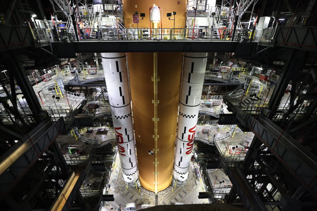

    The core stage for NASA's Artemis II mission was positioned between the rocket's twin solid-fueled boosters
    last month inside the Vehicle Assembly Building in Florida.
