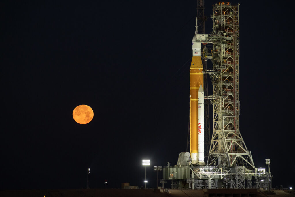

    The full Moon is seen behind the Space Launch System rocket at NASA’s Kennedy Space Center in Florida. The Tail Service Mast Umbilicals (TSMUs) are the gray structures that extend above the launch platform on the bottom left of the core stage.
