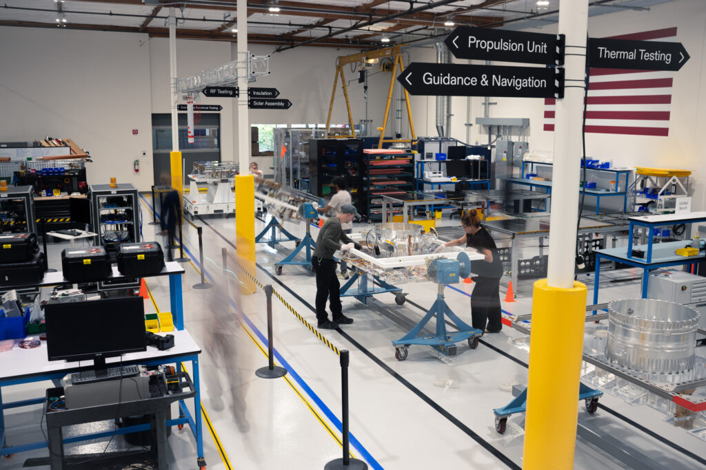

    A view of the Xona Space Systems satellite factory in Burlingame, California. The foreground shows a signpost with signs pointing toward "propulsion unit," "guidance & navigation" and "thermal testing."
