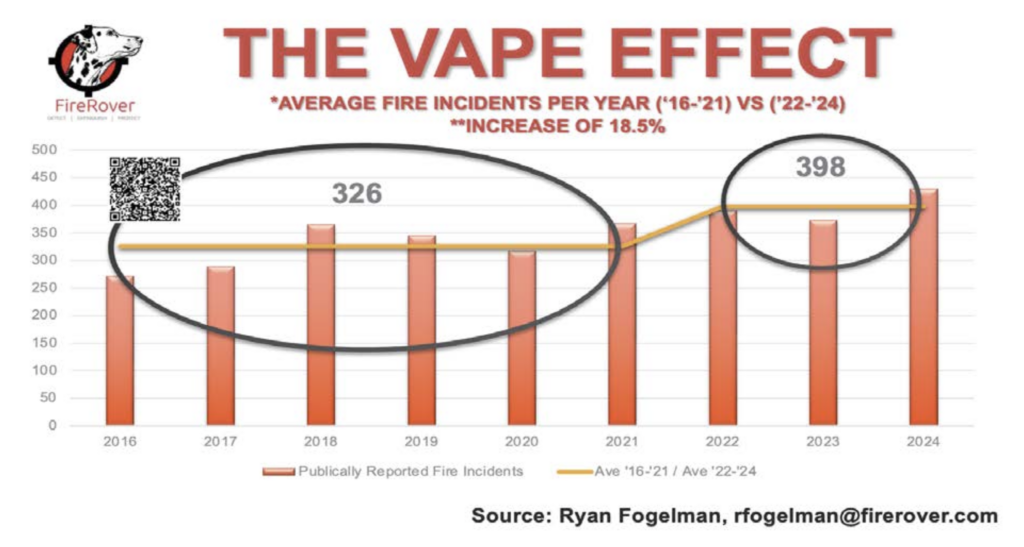

    The vape effect
    Batteries as a whole are a growing concern, but there's a reason Fire Rover's report has an image of an exploding electronic vape pen on its cover, with the superimposed message "We are at war 2024." Fogelman sees a notable shift in publicly reported fire data—not from Fire Rover's own detection, but from news and other reports and sources—from the 2016–2021 period to 2022–2024. Something is causing this shift, and Fogelman's most likely culprit is e-cigarettes, vapes, and other battery-powered nicotine devices.
