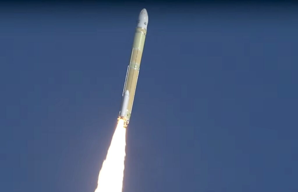

    The H3 is a relatively new vehicle, with last month’s launch marking the eighth flight of Japan’s flagship rocket. The launcher falls on the medium-to-heavy section of the lift spectrum. The eighth H3 rocket lifted off from Tanegashima Island in southern Japan on December 22, local time, carrying a roughly 5-ton navigation satellite into space.
    The rocket was supposed to place the Michibiki 5 satellite into an orbit ranging more than 20,000 miles above the Earth. Everything was going well until the H3 jettisoned its payload fairing, the two-piece clamshell covering the satellite during launch, nearly four minutes into the flight.
    Officials from the Japan Aerospace Exploration Agency (JAXA) are starting to get a handle on what happened. Agency officials briefed the government ministry overseeing Japan’s space activities last week, and the presentation (in Japanese) was posted on a government website.
    The presentation is rich in information, with illustrations, a fault tree analysis, and a graph of in-flight measurements from sensors on the H3 rocket. It offers a treasure trove of detail and data most launch providers decline to release publicly after a rocket malfunction.
    Japan’s eighth H3 rocket climbs away from Tanegashima Space Center on December 22, 2025, with the Michibiki 5 navigation satellite.
