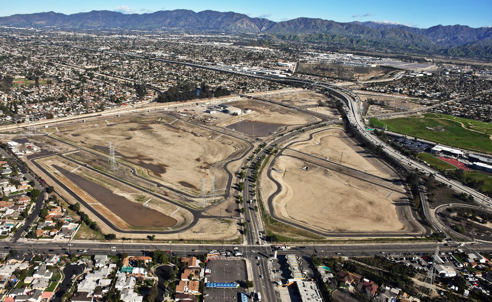

    To that end, LA’s new streetside green spaces feed underground water tanks for the city to tap into later. The water district also recently completed an enhancement of the 150-acre Tujunga Spreading Grounds (shown at the top of this story), giant basins that are on average 20 feet deep. The stormwater is piped in, then gradually seeps into the dirt, recharging local groundwater. The Los Angeles Department of Water and Power expects the spreading grounds to capture 16,000 acre-feet of rainwater a year, enough to nourish 64,000 households. (“Acre-feet” means the amount of water that would spread a foot deep over an acre of land.)
    Of course, Los Angeles isn’t exactly known for its abundance of open spaces, so it’s not like the water district can build spreading grounds all over. Instead, city planners are getting creative about using the green spaces LA already has, experimenting with inflatable rubber dams that can funnel rainwater into concrete structures under existing parks. These containers have permeable bottoms that allow the water to drip through, preventing flooding in the surrounding community and capturing a precious resource.
