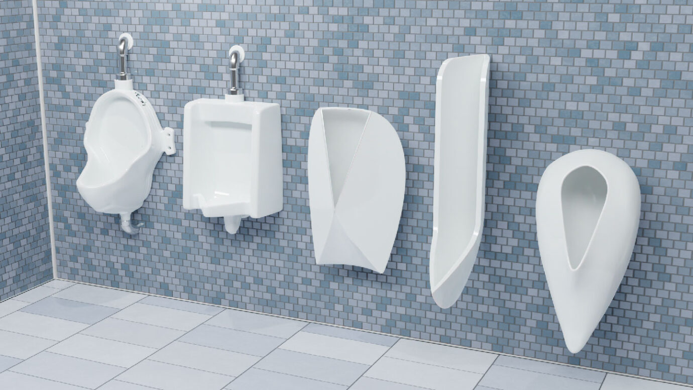

    Restroom visitors can expect cleaner knees and tidier floors, if they happen to use a new urinal inspired by curves in nature.
    The key to making a splashless urinal is ensuring that a person’s pee stream hits the porcelain at a shallow angle no matter where it is aimed, researchers report November 22 at the American Physical Society’s Division of Fluid Dynamics meeting in Indianapolis.
    “For a small enough angle, there is no splash,” says mechanical engineer Zhao Pan of the University of Waterloo in Canada. Pan calls the angle where splashing ceases “the critical angle.” Keeping the angle that a fluid strikes the surface at the critical angle or lower prevents the splash.
    Pan and colleagues’ design — a tall, narrow urinal with a curving inner surface — employs the same geometry as a nautilus shell (SN: 4/1/05).
    “There’s a smooth flow across the surface,” says Waterloo mechanical engineering student Kaveeshan Thurairajah, which prevents droplets from flying out.
    In experiments involving dyed fluids sprayed into conventional urinals, the team found significant splash that, in the real world, would have ended up on a person’s legs and feet and on the floor nearby. When the researchers repeated the experiments with prototypes of the new design and inspected the surrounding surfaces, “I couldn’t find even a single droplet,” Thurairajah says.
