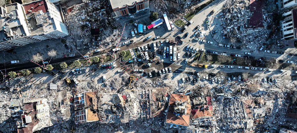

    TURKEY AND SYRIA’S 7.8-magnitude quake on Monday is a brutal reminder that deep down, planet Earth still hides secrets. Scientists know full well that faults are prone to earthquakes, but they can’t tell when a shaker will strike or how big it’ll be. If they could, the death toll wouldn’t stand at over 20,000 so far—and rescuers are still scrambling to find survivors
