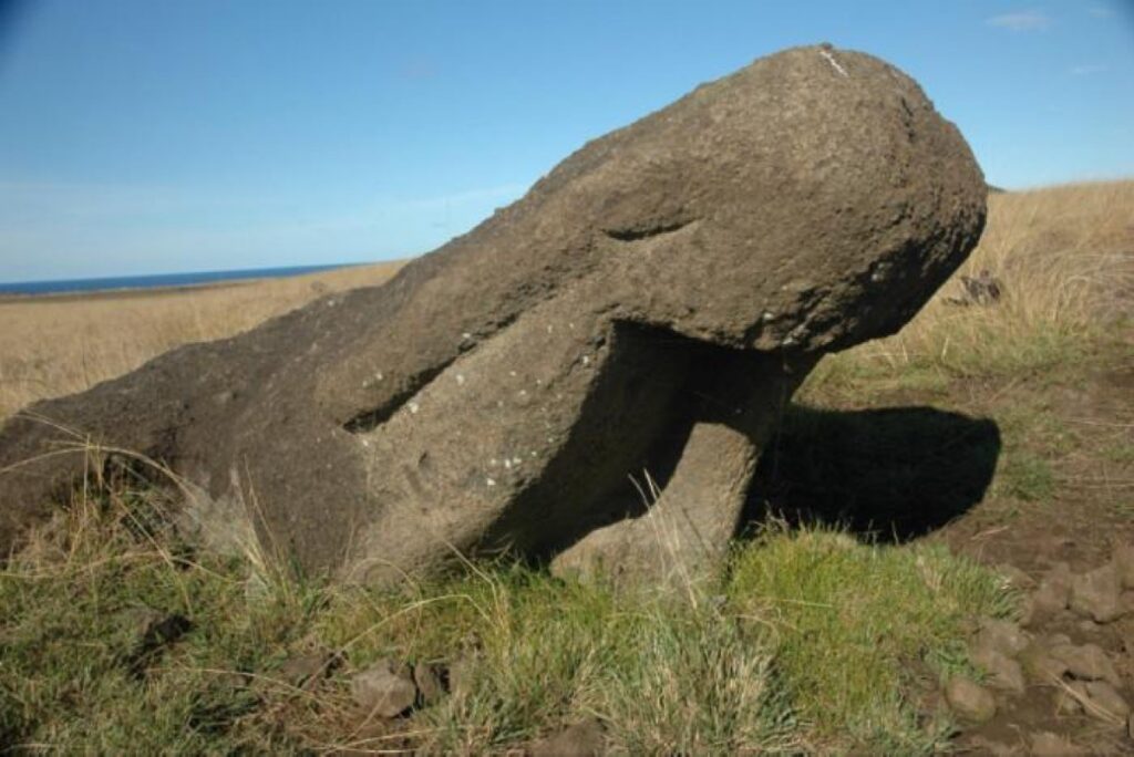

    Example of a road moai that fell and was abandoned after an attempt to re-erect it by excavating under its base, leaving it partially buried at an angle.

    You can have ahu (platforms) without moai (statues) and moai without ahu, usually along the roads leading to ahu; they were likely being transported and never got to their destination. Lipo and Hunt have amassed a database of 962 moai across the island, compiled through field surveys and photogrammetric documentation. They were particularly interested in 62 statues located along ancient transport roads that seemed to have been abandoned where they fell.

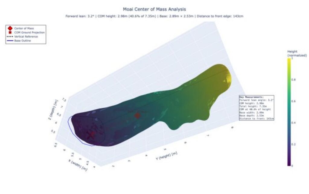

    Their analysis revealed that these road moai had significantly wider bases relative to shoulder width, compared to statues mounted on platforms. This creates a stable foundation that lowers the center of mass so that the statue is more conducive to the side-to-side motion of walking transport without toppling over. Platform statues, by contrast, have shoulders wider than the base for a more top-heavy configuration.
    The road moai also have a consistent and pronounced forward lean of between 6 degrees to 15 degrees from the vertical position, which moves the center of mass close to or just beyond the base's front edge. Lipo and Hunt think this was due to careful engineering, not coincidence. It's not conducive to stable vertical display but it is a boon during walking transport, because the forward lean causes the statue to fall forward when tilted laterally, with the rounded front base edge serving as a crucial pivot point. So every lateral rocking motion results in a forward "step."
    Per the authors, there is strong archaeological evidence that carvers modified the statues once they arrived at their platform destinations, modifying the base to eliminate the lean by removing material from the front. This shifted the center of mass over the base area for a stable upright position. The road moai even lack the carved eye sockets designed to hold white coral eyes with obsidian or red scoria for pupils—a final post-transport step once the statues had been mounted on their platforms.

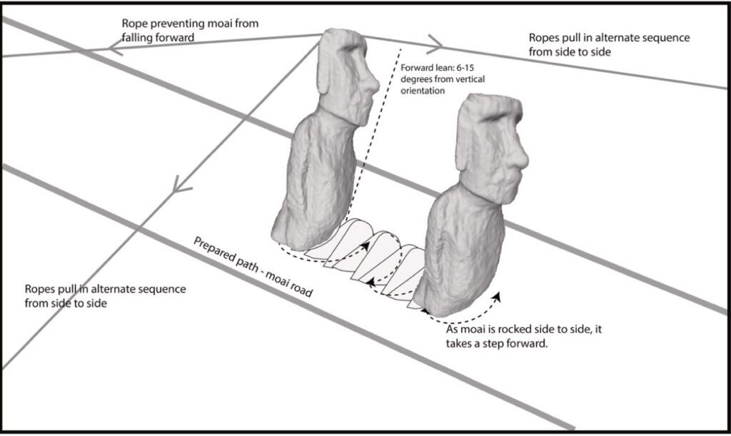

    The new field trials required 18 people, four on each lateral rope and 10 on a rear rope, to achieve the side-to-side walking motion, and they were efficient enough in coordinating their efforts to move the statue forward 100 meters in just 40 minutes. That's because the method operates on basic pendulum dynamics, per the authors, which minimizes friction between the base and the ground. It's also a technique that exploits the gradual build-up of amplitude, which "suggests a sophisticated understanding of resonance principles," Lipo and Hunt wrote.
    So the actual statues could have been moved several kilometers over the course of weeks with only modest-sized crews of between 20-50 people, i.e., roughly the size of an extended family or "small lineage group" on Easter Island. Once the crew gets the statue rocking side to side—which can require between 15 to 60 people, depending on the size and weight of the moai—the resulting oscillation only needs minimal energy input from a smaller team of rope handlers to maintain that motion. They mostly provide guidance.

    Lipo and Hunt also analyzed the roadways, noting that these ancient roadbeds had concave cross sections that would have been problematic for moving the statues horizontally using wooden rollers or frames perpendicular to those roads. But that concave shape would help constrain rocking movement during vertical transport. And the moai roads were remarkably level with slopes of, on average, 2–3 percent. For the occasional steeper slopes, such as walking a moai up a ramp to the top of an ahu, Lipo and Hunt's field experiments showed that these could be navigated successfully through controlled stepping.
    Furthermore, the distribution pattern of the roadways is consistent with the road moai being left due to mechanical failure. "Arguments that the moai were placed ceremonially in preparation for quarrying have become more common," said Lipo. "The algorithm there is to claim that positions are ritual, without presenting anything that is falsifiable. There is no reason why the places the statues fell due to mechanical reasons couldn't later become 'ritual,' in the same way that everything on the island could be claimed to be ritual—a circular argument. But to argue that they were placed there purposefully for ritual purposes demands framing the explanation in a way that is falsifiable."
