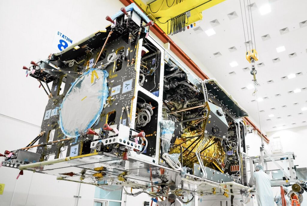

    NASA will cannibalize the core module of Gateway for the SR-1 mission. The Power and Propulsion Element, or PPE, is under construction at Lanteris Space Systems in Palo Alto, California. The module will have the most powerful electric propulsion system ever flown in space, with three 12-kilowatt engines and four 6-kilowatt thrusters. The PPE would have originally relied entirely on solar power. Under NASA’s new plan, it will have solar arrays and a uranium-fueled fission reactor.

    Gateway’s Power and Propulsion Element, seen here under construction last year, will form the centerpiece of the SR-1 Freedom mission.

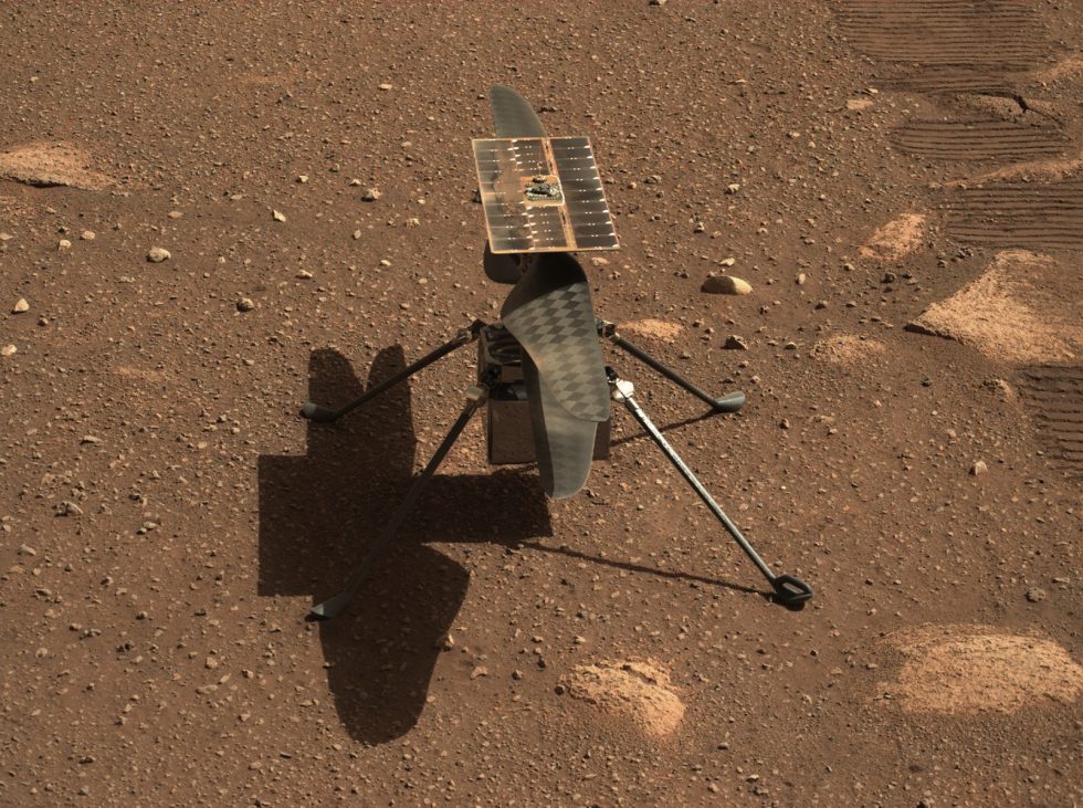

    There is one additional payload that NASA says will ride to Mars with the SR-1 Freedom spacecraft. The mothership will release three flying drones, each based on NASA’s Ingenuity helicopter, to land on Mars and scout future landing sites for human explorers.
    These copters, presumably built at NASA’s Jet Propulsion Laboratory, will carry cameras and ground-penetrating radars to scan the Martian terrain for subsurface water ice. They will land themselves on Mars after plunging through the Martian atmosphere.
    1-PIA24547-Mastcam-Z-Gives-Ingenuity-a-C
    NASA’s Ingenuity Mars helicopter is seen here in a closeup taken by Mastcam-Z, a pair of zoomable cameras aboard the Perseverance rover.
    “After separating from SR-1 Freedom, the entry capsule enters the Martian atmosphere at hypersonic speeds greater than Mach 5, slowing to approximately Mach 2,” Sinacore said. “Next, a supersonic parachute deploys to slow the capsule further, and finally, the heat shield separates and the helicopters are released in a first-ever mid-air deployment.”
