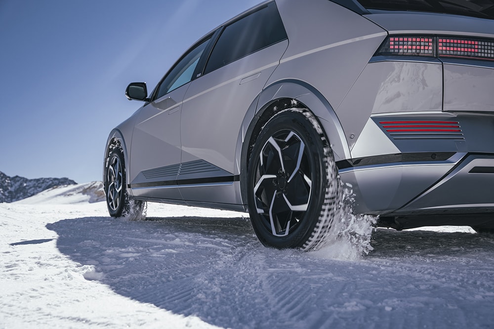

    Tire life
    Enlarge / In 2022 Hankook introduced a winter tire for EVs.
    Hankook
    Even in the relatively short time frame that EVs have been on the market, some owners have noted a short lifespan on their tires compared to those on ICE vehicles—sometimes drastically so. And that's important because EV customers face a pretty hefty bill to replace their tires, sometimes more than once. A friend of this author just replaced the tires on his Tesla Model S after a mere 4,000 miles due to wear. This balance between long life and traction is even more delicate with tires fitted to EVs than those on ICE vehicles.
