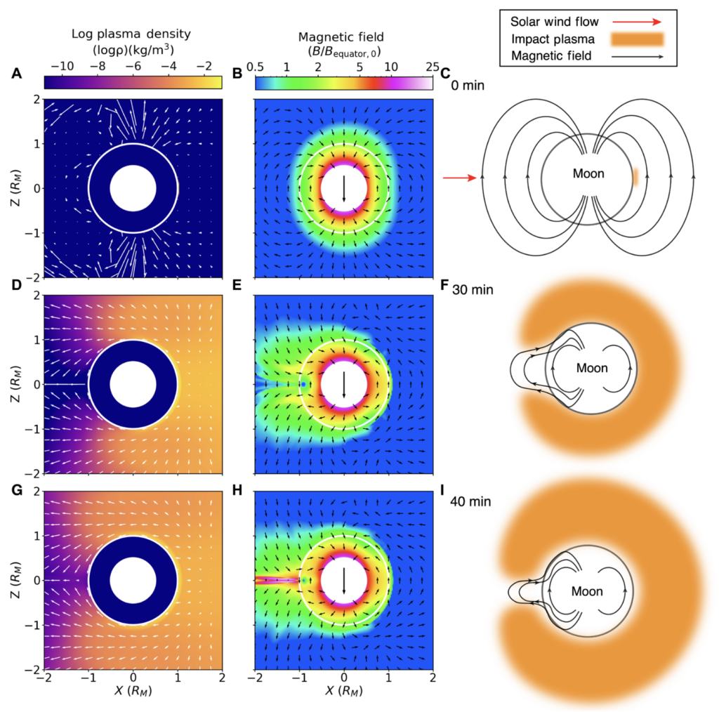

    In 2020, two of the current paper's authors, MIT's Benjamin Weiss and Rona Oran, ran simulations to test whether a giant impact could generate a plasma that, in turn, would amplify the Moon's existing weak solar-generated magnetic field sufficiently to account for the levels of magnetism measured in the moon rocks. Those results seemed to rule out the possibility. This time around, they have come up with a new hypothesis that essentially combines elements of the dynamo and the plasma-generating impact hypotheses—taking into account an impact's resulting shockwave for good measure.
    Amplification of the lunar dynamo field by an Imbrium-­ sized impact at the magnetic equator.
    Amplification of the lunar dynamo field by an Imbrium-­sized impact at the magnetic equator.
    Credit: Isaac S. Narrett et al., 2025
    They tested their hypothesis by running impact simulations, focusing on the level of impact that created the Moon's Imbrium basin, as well as plasma cloud simulations. Their starting assumption was that the early Moon had a dynamo that generated a weak magnetic field 50 times weaker than Earth's. The results confirmed that a large asteroid impact, for example, could have kicked up a plasma cloud, part of which spread outward into space. The remaining plasma streamed around to the other side of the Moon, amplifying the existing weak magnetic field for around 40 minutes.
    A key factor is the shock wave created by the initial impact, similar to seismic waves, which would have rattled surrounding rocks enough to reorient their subatomic spins in line with the newly amplified magnetic field. Weiss has likened the effect to tossing a deck of 52 playing cards into the air within a magnetic field. If each card had its own compass needle, its magnetism would be in a new orientation once each card hit the ground.
