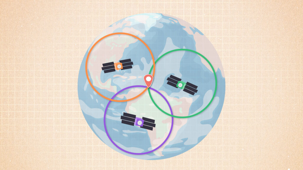

    GPS works in a deceptively simple way: Each satellite carries an atomic clock aboard. It broadcasts that clock’s time toward Earth. That signal alone is what’s useful to energy infrastructure and financial transactions. But to get position information, a receiver—in a phone or other device—simply has to pick up signals from at least four satellites. It knows what time those signals were sent, where the satellites were when they sent them, and how long it took the signals to arrive. Through fancy triangulation, the phone (or guided missile) then computes its own location.
    Or at least that’s the idea. GPS can be jammed, meaning that someone broadcasts a signal much stronger than that of GPS (which has had to travel across thousands of miles of space, and grows weaker with every meter), drowning the real signal in noise. It can also be spoofed, meaning someone sends out a fake signal that looks just like a GPS blip but indicates an incorrect location or time.
    Image of the globe centered on the Caribbean. Three satellites are superimposed on it, each of them with a colored circle around it. A pin highlights the point where the three circles intersect.
    Three satellites are needed to pinpoint a location on Earth.

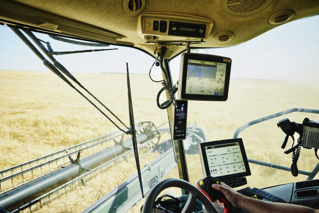

    Image of the inside of the cabin of a large farming machine moving through a field of wheat. Screens track its current location and where it has been.
    Reliable GPS has become essential for a huge range of industries.
