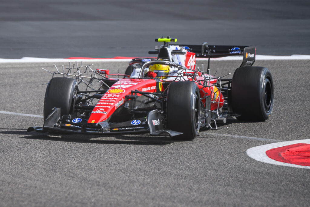

    Lewis Hamilton of the Scuderia Ferrari HP F1 Team participates in Formula 1 Pre-Season Testing 1 in Sakhir, Bahrain, on February 11, 2026. (Photo by Ahmad AlShehab/NurPhoto via Getty Images)
    Ferrari has shown real signs of speed during testing, but also a few problems. The contraption attached to the car measures wind pressure to correlate wind tunnel data with the real world.

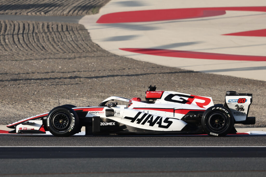

    Oliver Bearman of Haas during the Formula 1 pre-season testing at Sakhir Circuit in Sakhir, Bahrain on February 13, 2026. (Photo by Jakub Porzycki/NurPhoto via Getty Images)
    2026 cars look good.
    I’ll say this for the 2026 crop of cars: They sure look good. They’re a little shorter and narrower than last year’s cars, with slightly narrower tires and much greater diversity among the teams than in the tightly proscribed ground-effect era. Those rules, which ran from 2022 to 2025, gave such little leeway to the teams in design decisions that performance converged to within fractions of a percent across the entire grid. Now everyone looks quite different from one another.

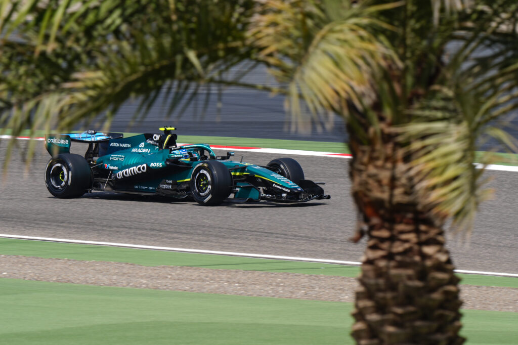

    Aston Martin's Fernando Alonso during day two of Formula One Aramco Pre-Season Testing at Bahrain International Circuit, Sakhir. Picture date: Thursday February 12, 2026. (Photo by Bradley Collyer/PA Images via Getty Images)
    Huge sums have been invested in Aston Martin, to little effect so far.
    I’m pretty sure the unbelievable reliability that’s been a feature of F1 for the last few seasons may be a thing of the past, at least for the first few races in 2026. Up and down the pit lane, teams have missed hours of practice sessions as they troubleshoot gremlins. Aston Martin looks particularly bad in this regard, even in comparison to brand-new Cadillac.
