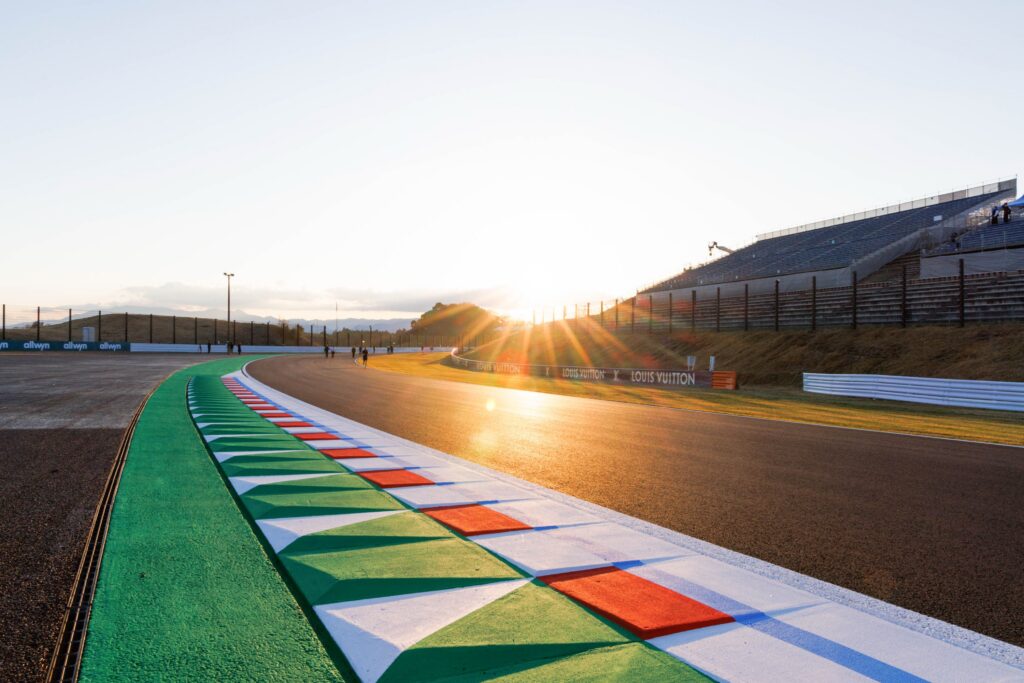

    SUZUKA, MIE PREFECTURE, JAPAN - 2026/03/26: The sun sets on the ripple strip at the exit of the 130R corner ahead of the F1 Grand Prix of Japan at the Suzuka Circuit. (Photo by George Hitchens/SOPA Images/LightRocket via Getty Images)
    130R: Used to be a challenge, then it was easy flat, now they slow down and coast all the way through.

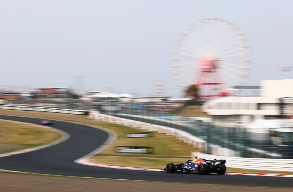

    Unlike many F1 fans (and some of the drivers), I have tried hard to be positive about the 2026 technical regulations. That posture became very difficult to maintain after watching the cars qualify. The most famous corner at Suzuka is called 130R, a fast left toward the end of the lap that comes after a long flat-out run from Spoon. It used to be a challenge, but last year, 130R was barely a corner; the cars had so much downforce that they went through it on rails.
    If you thought that was bad, it was all forgotten this year as drivers coasted through the corner all the way to the Casio Triangle instead, losing up to 50 km/h (32 mph) from the apex of 130R. Watching the onboard footage of cars slowing through 130R was, frankly, demoralizing, as was the similar sight of cars lifting and coasting into turn 1.
    “The problem is, of course, you have a long straight and then only a little chicane and then a long straight again,” said Red Bull’s Max Verstappen. “So if you deploy in one straight, you have nothing on the other. Whereas on some other tracks, if you have a long straight, then you have maybe a few corners and you have time to charge. Here, you don’t.”
    That’s now also true for turn 1 and Spoon—instead of braking from high speed, the cars begin to decelerate halfway down the straight, then begin their coast phase well before the corner.
    So the fastest way around an entire lap is now no longer going flat out but instead choosing where and when to deploy that precious and limited energy. “I was a bit disappointed in qualifying, as the more you pushed, the slower you went,” said Williams driver Carlos Sainz. “That’s what happened to me in Q2. I think I had a bit less slipstream on my lap and I was in clean air, I went quicker in every corner, slower in every straight, and I went one tenth slower. And that’s simply because I spent more time at full throttle because I went faster in the corners and pushed harder. Super clipping came into the deployment a bit, and a bit of lift and coast also in that qualifying lap. Overall, not good enough, I think, for F1.”
