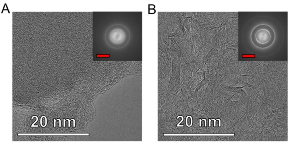

    Plus, Eddy had access to Edison’s original 1879 patent describing the invention process. Eddy recreated Edison’s experiment, attaching light bulbs to a 110-volt power source and switching it on for 20 seconds at a time to rapidly heat the carbon-based material to between 2000 to 3000 degrees C. (Switch it on for any longer and you get graphite rather than graphene.) Then he examined the results using a modern optical microscope.

    TEM image of the raw carbon filament before and after Joule heating. Distinct graphene layers are observed within the filament
    TEM image of the raw carbon filament before and after Joule heating. Distinct graphene layers are observed within the filament in (B), among some regions of unconverted amorphous carbon.
    This time, Eddy noticed that the carbon filament turned to a “lustrous silver.” Raman spectroscopy revealed that parts of the filament had turned into turbostratic graphene. The team also took before and after images using transmission electron microscopy. Eddy and his co-authors acknowledge that this is not definitive proof that Edison produced graphene. The inventor lacked the means to detect it even if he had been aware that such a material existed. And even if one were to analyze Edison’s original bulb, any graphene would have long since turned into graphite.
