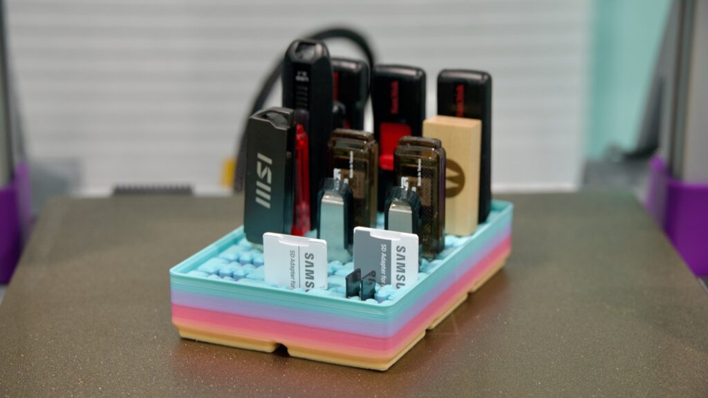

    Cleaning out and fully organizing my desk with 3D-printed baskets and containers is still on my long to-do list, but I did manage to tame the loose pile of USB sticks and memory cards in my desk with one of the many available organizer designs. This Gridfinity-compatible design is the one I went for, but there are truly dozens of examples on MakerWorld alone; I like this one because it can hold a lot of USB-A drives and because each individual slot is versatile enough to hold USB drives or SD or microSD cards. But there are examples with more USB-C ports and some with different dimensions and spacing, so you can find the one that works best for the space you're trying to fit it into.

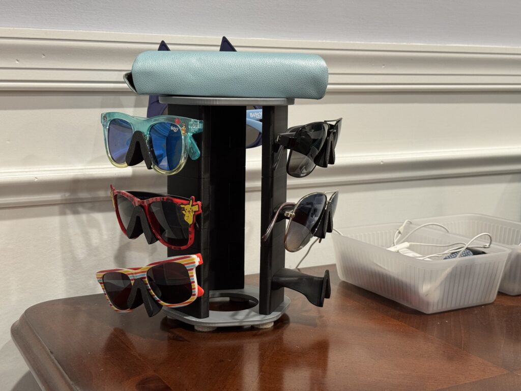

    Who doesn't need to be able to store multiple pairs of Bluey sunglasses?
    Credit: Andrew Cunningham
    Having a third sunglasses-wearer in the house (and one with multiple Bluey sunglasses) also made it necessary to find some kind of way to easily put them away and keep them from floating around the living room or car and getting lost forever. I really like the versatile and modular SnapStack Modular Glasses Holder design, which gives you designs for a base and a top, and then you print as many sunglasses holders as you need; if you need to expand later on, just print another one or pop the top off and add to the one you've already made.
    We had enough things to store that I went right for this three-sided version of the stand, which I printed to be able to hold nine pairs (and which is large enough that you can rest a sunglasses case or something else on the top). I stuck a few small adhesive furniture pads to the bottom to prevent damage to the table. But if you have fewer, you can print free-standing or wall-mounted versions, too.
    Andrew Cunningham, Senior Technology Reporter

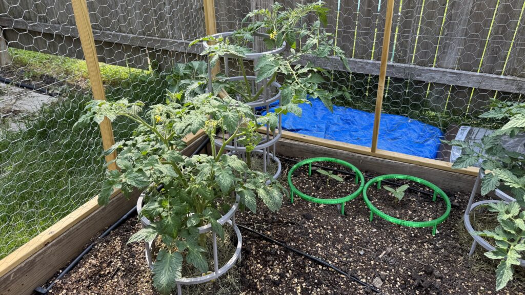

    After several years of dashed hopes and false starts, I was finally able to get a single raised garden bed going in our backyard this year (among other things, a raised bed is a bit easier to protect from the wildlife in our backyard and simpler to use with the Square Foot Gardening system). The 3D printer contributed a few odds and ends, including parts that helped add strength to the enclosure I built around it and tools that helped me keep the cage's corners (mostly) square.
    But now that some of the plants are actually going, the 3D printer's main contribution to the cause has been 3D-printed cages, which I've been using to get my vining plants to grow upward instead of outward (necessary for the close quarters of square-foot gardening) and to keep things from flopping over onto the ground.
    As with the desk organizers, there are many options for plant cages and trellises, depending on the size of your plants, what you're trying to grow, and your aesthetic and functional preferences. I'm giving these circular stackable ones a try since I like that they can easily be printed continuously based on how high your plants want to get, though for big ol' tomato plants, you’ll still want a stake in the ground to help bear the weight once the plants are more than a few feet high.
    If you do this—and especially if you're using an open-bed printer like my Bambu Labs A1, which doesn't handle filament like the UV-resistant ASA well—you'll want to make sure to print using PETG plastic instead of the typical PLA. PETG can be fussier than PLA (it's more prone to stringing, especially if you're not drying your filament rolls), but it's also less prone to warping after extended sunlight exposure, it's modestly UV-resistant, and it has a bit more flexibility and resiliency than the more brittle PLA plastic.

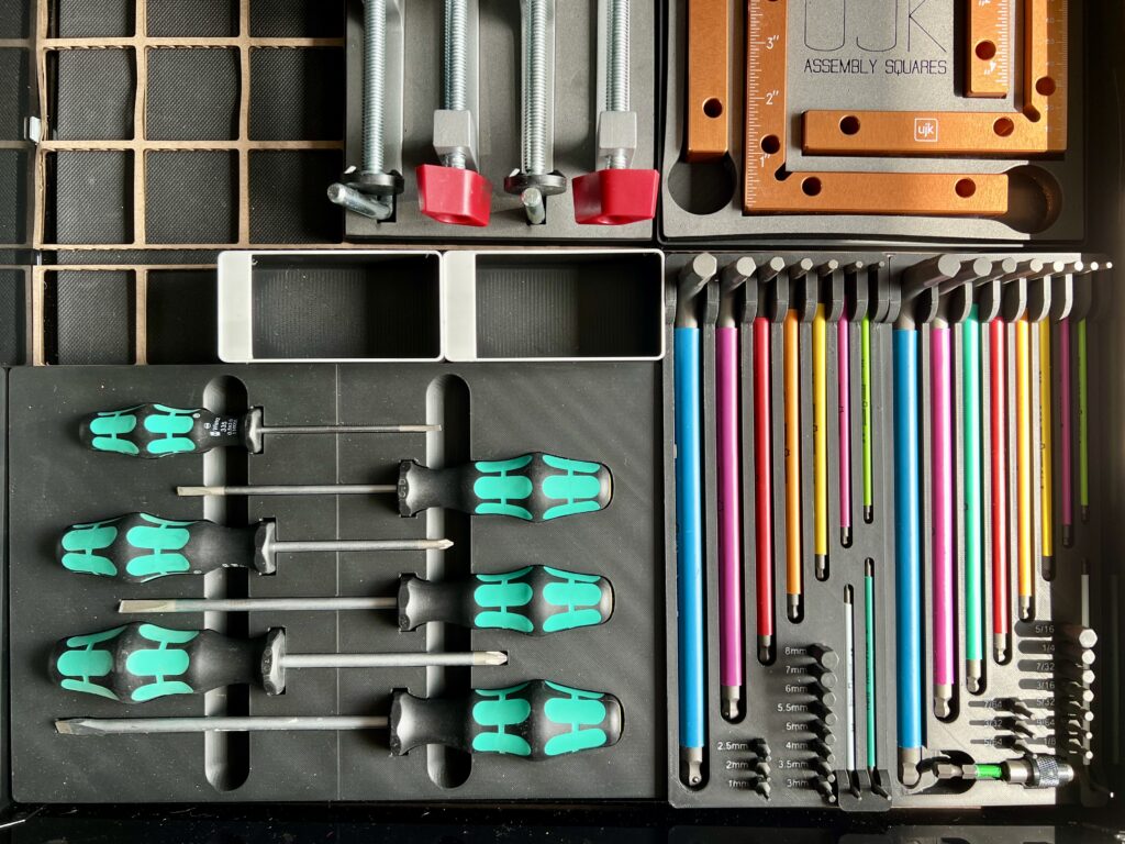

    I also liked the idea of Gridfinity, but I found the 42 mm size a little awkward—and yes, it’s a Hitchhiker’s Guide reference, not a spec built around the size of human fingers. I modeled my own system in Fusion 360 based loosely on the idea, but with a 50 mm grid that I laser-cut out of cardboard to avoid having to print it. The containers are printed in matte black and white PLA, with a color switch using my X1C’s AMS multi-spool system to get the white tops. There’s no function to the white; I just thought it looked nice with the labels.
    Custom holders for Wera screwdrivers and hex wrenches.
    Credit: Aurich Lawson
    I modeled custom holders for another drawer to hold my screwdrivers and hex wrenches. Having the perfect shape to fit the screwdrivers is slightly overkill, but it’s super satisfying to drop them into place and watch them settle exactly into place. There's a metric and imperial holder for the hex wrenches, each removable, so I can take them with me to find the right fit when I'm working on something. All the holders lock into the same 50 mm grid as the bins.
    —Aurich Lawson, Creative Director
