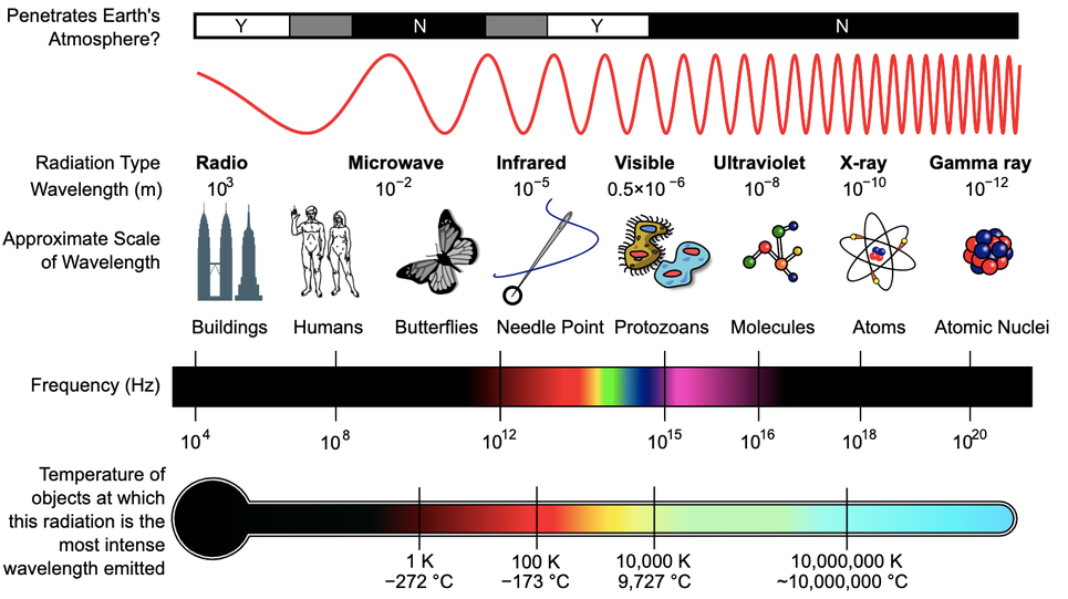

    Astronomy is often done outside the visible spectrum, because many of the most interesting objects in space are shining brightly in ultraviolet, x-rays, and even radio waves (which category light falls into depends on the photon’s wavelength). The Webb Telescope is designed to see infrared light, whose wavelengths are longer than red visible light but shorter than microwaves.
    Infrared light can penetrate thick clouds of gas and dust in space, allowing researchers to see previously hidden secrets of the universe. Especially intriguing to scientists is that light from the early universe has been stretched as the universe has expanded, meaning what was once ultraviolet or visible light may now be infrared (what’s known as “redshifted” light).
    The wavelengths of the electromagnetic spectrum.
    Graphic: Wikimedia Commons
