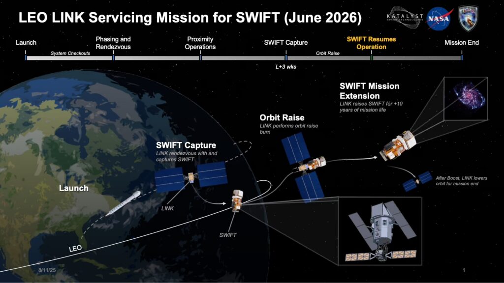

    Concept of operations for the Swift rescue mission.

    After launch, it will take several weeks for the rescue spacecraft to reach Swift. Katalyst’s servicer will approach slowly, and sensors on the robotic arms will attempt to find edges to grab onto.
    “No matter what, we’re going to learn a lot. We don’t know exactly what configuration it is in,” the manager said. “We don’t know exactly which surfaces are grabbable… but that’s why we’re kind of engineering our systems to be as versatile and robust as possible.”
