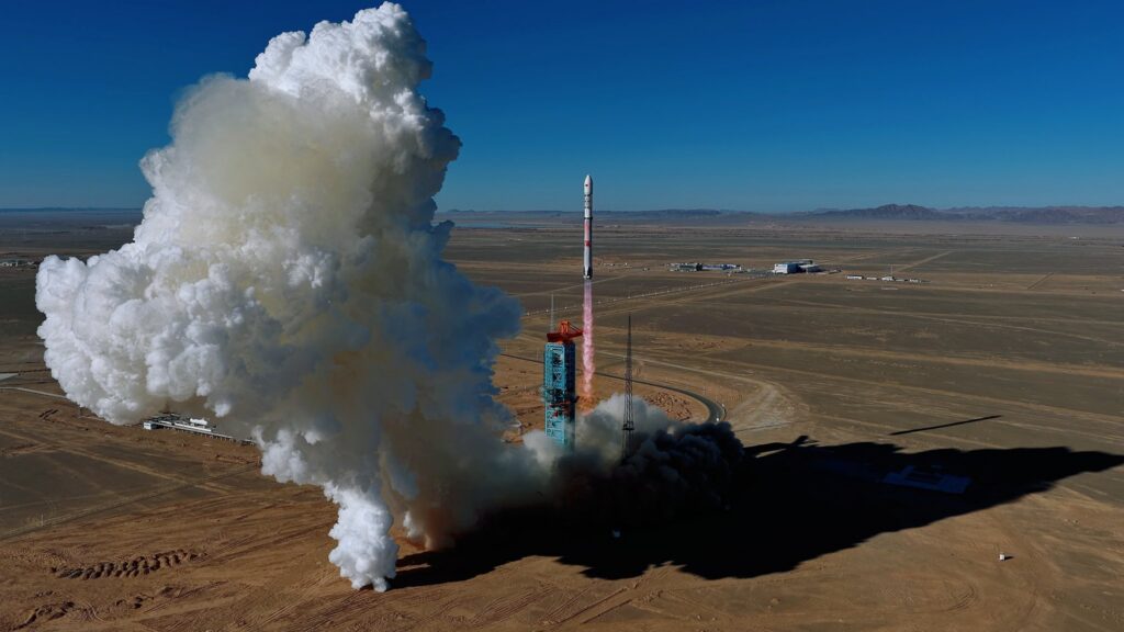

    Powered by nine methane-fueled engines, the Zhuque-3 (Vermillion Bird-3) rocket climbed away from its launch pad with more than 1.7 million pounds of thrust. The 216-foot-tall (66-meter) launcher headed southeast, soaring through clear skies before releasing its first stage booster about two minutes into the flight.

    LandSpace’s 216-foot-tall (66-meter) Zhuque-3 rocket lifts off from the Jiuquan Satellite Launch Center in northwestern China.

    The Zhuque-3 rocket begins its first flight.
