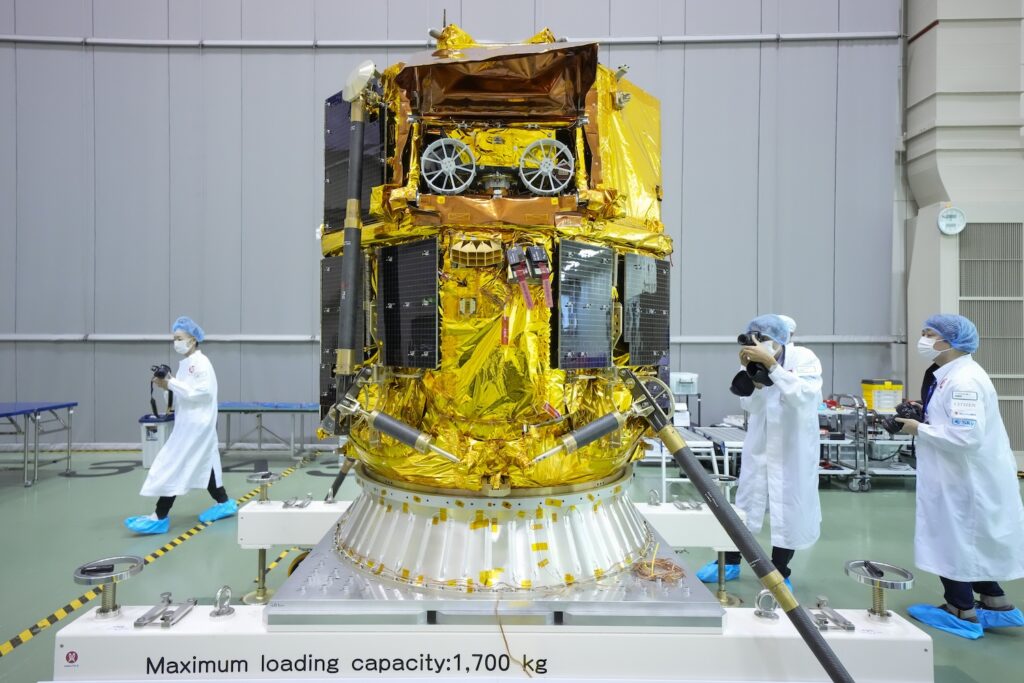

    The Resilience lander and Tenacious rover, seen mounted near the top of the spacecraft, inside a test facility
    at the Tsukuba Space Center in Tsukuba, Ibaraki Prefecture, on Thursday, Sept. 12, 2024.
